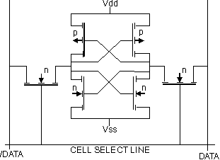

In addition when we look at the most common type, NMOS, there are two categories of memory device; static RAM and dynamic RAM.
One example of a CMOS static RAM cell is shown below.

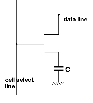

To reduce the amount of time spent in refreshing each memory chip is organised as a matrix of cells and when a bit in any row is read the entire row (of perhaps 256) cells is refreshed. Thus to refresh the entire chip one read operation has to be performed on every row (again typically 256). Also all the chips in the system can have their row addresses connected together so that the same row in every chip is refreshed at the same time. Thus only 256 read cycles are needed every 2ms to keep the memory intact. A dynamic memory controller ensures that at regular intervals a memory refresh cycle takes place on the next row - often this can be done when the processor is not accessing memory but sometimes it is necessary to make the processor wait while the refresh takes place.
The big advantage of dynamic memory which makes the extra complication of refreshing worthwhile is that because of the simplicity of the memory cell very many more bits can be fitted on the same size of chip (typically a factor of 8). Thus while 1MBit memory chips are commonplace (and 4 MBit available) static memory devices 64 kByte is a more typical size. Another advantage is that unless the cell is being read from or written to it does not consume any power. Thus the overall power consumption is much lower.
Another problem in dynamic memories is that the capacitor on which the charge is stored is so small that a single ionising particle passing through it can sufficiently disrupt the charge pattern so as to cause a mis-read of the data. Thus in large memory systems, and ones where data integrity is crucial memory checking is necessary - either a simple parity check by adding one more bit to each word or a more complex check allowing correction which will add several bits to each word.

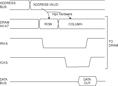

The address inputs to a DRAM are multiplexed into ROW and COLUMN addresses by a DRAM controller (or other multiplexing hardware).
For example, a small 64K x 1 DRAM chip (4164) has the pinout below:
This is a 64K bit device and 64K bits of memory needs 16 address lines. First, half of the 16 address lines are applied to the DRAM's A0-A7 with /RAS (and latched internally). Then the other half of the 16 address lines are applied to the DRAM's A0-A7 with /CAS as shown below.
